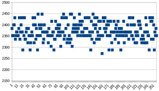

I am currently evaluating nrf52840 - CDSENET E73-2G4M08S1C module with installed CircuitPython 7.0.0-alpha.3. Unfortunately the ADC readings are quite noisy. For example for 256 consecutive readings of a DC signal (0.120V) from a potentiometer the stdev = 39.
Any way to improve this ?
  • Unfortunately the ADC readings are quite noisy
    How do you know it's not just your input signal that's noisy?
    Your readings seem to be around 2375 +/- 75; ie, a variation of ~ 3% - which is actually not so bad, unless you've taken very great care over your analogue front-end, supply, layout, grounding, shielding, etc ...
  • The input voltage is supplied from ultra-low noise LDO (TPS79933 – output noise voltage 34.65 uV). Also, I have a 47 uF capacitor on the input, as you can see from the picture it is high-frequency noise. In addition, a multimeter measured a stable value 120 mV, which it is a prove that the noise is in uV region. The measures from the internal ADC are in the range: 114.947 mV - 123.851 mV (-5.053 mV to +3.851 mV deviation from the average measure), which I consider not acceptable for the intended application.
  • a multimeter measured a stable value 120 mV, which it is a prove that the noise is in uV region
    Not really.
    A multimeter will do a lot of averaging.
  • With 47uF capacitor on the input ? Using the same LDO with STM32WB55 I get about 11 ENOB in 12-bit mode (no oversampling), deviation about 1 LSB. In the nrf52840 case what is the measured ENOB – 8 ?
    Unfortunately you must expect a couple of LSB deviation with the SAADC. Please see the replies by my colleagues in this and this ticket for more information.
    However, I would also say as @awneil already has; A multimeter is not suited to measure/identify noise, because of its averaging. Do you have access to an oscilloscope with which you could perform these measurements?

  • Switched to Micropython, as well as disabled the int. DC-DC regulator and used the following settings:
    .burst = NRF_SAADC_BURST_ENABLED
    nrfx_saadc_simple_mode_set((1 << adc_obj->id), NRF_SAADC_RESOLUTION_14BIT, SAADC_OVERSAMPLE_OVERSAMPLE_Over8x, NULL);
    The results (measuring 1.406 V) seems better – stdev = 4. The mainstream micropython ADC implementation adc.c is not using oversampling, calibration … As well as I was not able to find more advanced example configurations. Wondered if you could recommend some ?
    I am glad to hear that you are able to reduce the noise you are seeing when switching to Micropython, though I have never heard about Micropython personally.
    Are you now measuring the reference voltage with an oscilloscope?
    Enabling burst and oversampling should decrease the effects of noise on your output, since it then takes multiple samples in a row and averages them before outputting a single sample.
