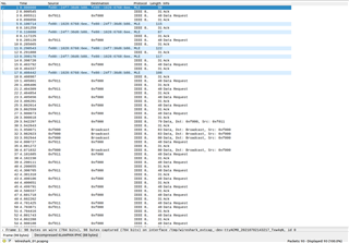

    If possible, can you upload a sniffer trace showing on-air communication between the devices? Please check out the nRF Sniffer for 802.15.4 for example that can be used to capture packetrs transmitted on protocols based on IEEE 802.15.4, like Thread for instance.

    thanks a lot for your answer. I tested the setting with a freshly flashed border router and DK with standard software and it still doesn't work. But when I reflashed the border router I came across a change I made (found it in my notes 6 month ago) after the flash. 6 month ago, I had the same problem with the mqttsn gateway, but with a normal enddevice (not sleepy enddevice). I used the example "mqttsn_client_publisher". The solution was to change the "GatewayUDP6Broadcast" address in /etc/paho-mqtt-sn-gateway.conf to "ff03::1" fitting the address in the SDK. After restarting the gateway, everything worked fine. Now, I thought maybe that is the problem, so I changed it back to the original one "ff33:40:fdde:ad00:beef:0:0:1", but it didn't work neither. Do you think it has something to do with that address because the discription inside the conf says:

    The sniffer results are quite old. I haven't used the standard mesh local prefix there. But I can create new ones.
