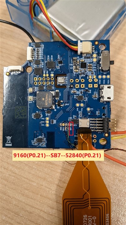

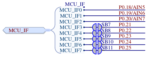

    I’m still not quite sure how you physically can access P0.21 on the Thingy:91. Could you elaborate and/or send me a picture of it?
    As it is mentioned in Thingy:91 pin mapping (SB7 is connected to P0.21 on the 9160 side and P0.21 on the nrf52840 side) in the following image:
    I want to establish a communication between 9160 and 52840. For which I am thinking to use MCU_IF3 as signal line (a high from 9160 will indicate 9160 wants to connect with 52840). So, I tried configuring P0.21 from 52840 side as Input GPIO, and P0.21 from 9160 side as Output GPIO. Here is the picture of Thingy:91 to make it more clear for you.
    I am testing with oscilloscope on SB7 highlighted with red square in the image.
