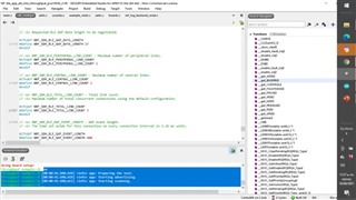

    Thanks for your reply. I have nrf52840-DK boards (www.google.com/search with SDK 17.0.2., I have set the number of links as well as pheripherals but when I run the program with the 3 boards, on the tester terminal it still gets stuck scanning and in the debugging i don't get any errors. I enclose screenshots of the terminal and sdk_config.h header file.

  • Hi
    Does one of the other test devices advertise in range of the scanner in this test? From the logs it just seems like the device is scanning as normal but isn't finding and connecting to an advertising device.
    Have you tried setting DEBUG in your preprocessor definitions? Also, what backend are you using for debugging in your sdk_config.h file?
