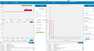

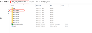

We update SDK from 11.0.0 Version to 17.0.2, the hardware is same, but from 17.0.2 package, we run DTM in single channel mode ,data lost is 40%. DTM from 11.0.0 package is ok. Flowing screen shot is what i am using. Any one give me help:

For the newest DTM, from SDK 17.0.2, include the fix:
In ble_dtm.c. line 1305:
m_packet_length = (parameter && LE_UPPER_BITS_MASK) << LE_UPPER_BITS_POS;
change to :
m_packet_length = (parameter & LE_UPPER_BITS_MASK) << LE_UPPER_BITS_POS;

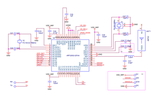

Your missing a matching network for the antenna, and you might have other improvements you can do in your design, but then I need to see the layout:
But you have used the same HW for all the tests.
Could you try to do the communication the other way, change the placement if TX and RX?
