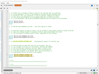

    If you use nRF5 SDK 15.3.0 or later and look at the source code, you should see that there is a FW update type called "External application". It's still an experimental feature, and documentation is lacking, but should be a good starting point for what you are trying to do.
    sdk_config.h setting from nRF5 SDK 17.0.2
    Do you expect Bank 1 on your device to be large enough to receive the full image before transferring it over SPI/i2c?
