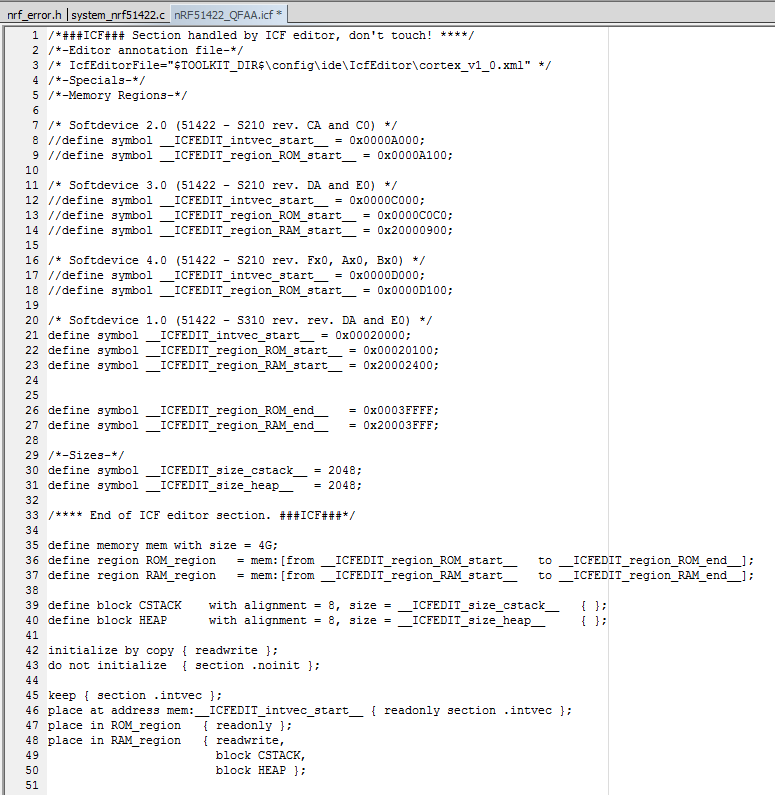

Here is my linker file image description

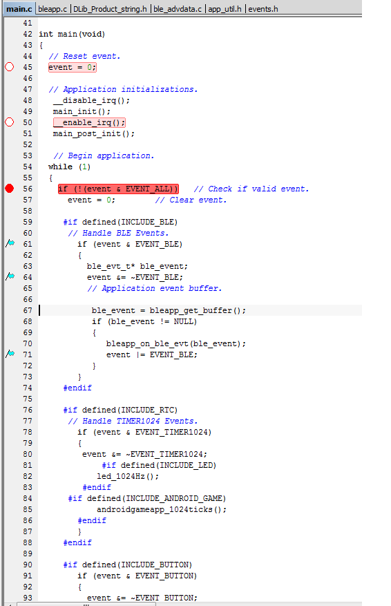

And main
main.png]
The gpio, clock, ble and rtc initializations happen in main_init() and main_post_init().
There are four strange behaviors
  1. When the code runs in the debugger it blows up and the PC points to the end of memory.
  2. When the code runs to a breakpoint on line 56 (in main) it blows up after the first step into the code once. However, it doesn't blow up if the assembly code is stepped through.
  3. When the code runs with a breakpoint on line 61 it doesn't make it there. When the program is paused the PC is pointing to address 0x20000008, which is inside RAM when s310 is disabled (from the S310 Soft Device Specification 1.0)

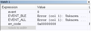

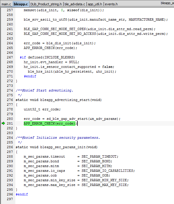

  4. When a service call is made to the soft device to start advertising ble packets, the error code below is returned.
image description
image description
image description
