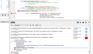

CONFIG_OPENTHREAD_JOINER_AUTOSTART=y -> results in -> otJoinerStart - undefined reference
I have modified the Openthread-CoAP example.

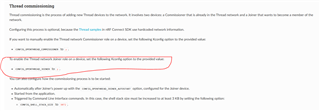

I'm am tring to build a device, that will automatically join an exsisting thread network. So there is the joiner-autostart configuration mentioned in the docs.

CONFIG_OPENTHREAD_JOINER=y

If i try to compile... the "otJoinerStart"-function can't be found by the linker. That means, there is none in the library?!!?
What is wrong? May be there is another config-option needed.
Please help me,
Thank you
