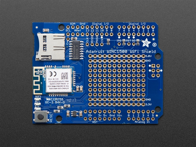

I'm having an issue adding WiFi functionality to my project. I use the nRF9160DK and the nRF Connect SDK v1.5.1 on a Windows10 platform.
To keep it simple i tried to integrated a WiFi-shield already supported by zephyr and fitting on the nRF9160DK, the Adafruit WINC1500. To evaluate the WiFi module i started with the wifi-sample provided by zephyr. My first step was writing a new nrf9160dk_nrf9160ns.overlay and nrf9160dk_nrf9160ns.conf file to build the project.

After pulling the hal_atmel library, the project builded successfully. First i had the problem that the atmel-driver version (v19.5.2) didn't support the firmware version on the WINC1500 (v19.4.4). When following the guide for the firmware-update, another issue showed up. About this i already opened a ticket at the Arduino Forum. In the meantime i was lucky and found another WINC1500-shield with an updated firmware (v19.5.4). Now the firmware check passes and i also get back the correct MAC-address, but afterwards i got in trouble when the driver tries to configure the scan region and other settings.

Debugging the project revealed a problem with the SPI. When trying to set the scan region, the error -6 comes back. According to Atmel this means a bus error. Here i'm confused since i already was able to communicate with the WINC1500. The error is returned by this function.
The functions to write or read registers (nm_write_regnm_read_reg_with_ret) seem to work fine. I observed that it is the first time the function nm_write_block is called in the initialization process. I think it is possible that there is a problem with the compatibility of the SPI drivers. Can anyone help me on this?
