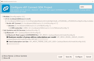

    The Mesh light sample project is configured by defualt with a maximum number of group address subscriptions per model to 1. You can change this either by going into the Configure nRFConnect SDK project option in SES if that's what you're using:
    Or you can edit the BT_MESH_MODEL_GROUP_COUNT in the subsys/bluetooth/mesh/Kconfig. Line 185.
