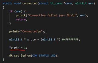

How to force nrf52840 (with cortex m4) to have precise bus error
Hey!
From this link it says one can force the cortex-m4 to disable write buffering. This is supposed to remove imprecise bus errors.
To do this i write 1 to bit 1 in the ACTLR using this code
	#include "core_cm4.h"
	volatile SCnSCB_Type *ptr_scnscb;
	ptr_scnscb = (SCnSCB_Type *)0xE000E000;
	ptr_scnscb->ACTLR |= SCnSCB_ACTLR_DISDEFWBUF_Msk;
However I still get imprecise bus errors and cant find the true cause, so what am I doing wrong?
