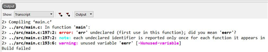

My error messages in Segger studio are messed up (shown below). Everything else is fine. Can I change the font or something?
[m[K'[01m[Kdev[m[K' undeclared (first use in this function); did you mean '[01m[Kdiv[m[K'?

  • I have only seen it in the Nordic Edition of SES so far. The release notes for the general edition of SES does not mention this color coding anywhere, and I did not see it when testing the latest version now. From what I have been told, the color coding was introduced in the error output from the tools behind SES. This is how the color coding looks if you select "Output" instead of "Tasks":
