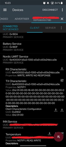

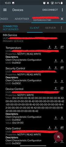

I have added a condition where on 'c' character input it sends a payload full of 0x00 except for 3 bytes. The payload works just fine with the NUS service, but it starts to get itchy when it comes to the custom service. The first 8 bytes (sometimes the first 16 bytes) repeat themselves for the entire length of the payload. I suspected first my parameters but then I took the same as the  NUS function, still the same problem. I also checked for parameters in sdk_config.h file like ATT_MTU but the value seems fine.
On the debugger; I looked for length pointer value once it is returned by hvx_params struct, and it said 8 but still wrote 69 bytes on the characteristic.
I work on Windows 10 with nRF52840 DK with nRF Connect for Mobile on my Android. My SDK is v17.0.2 and my softdevice is the pca10056.
