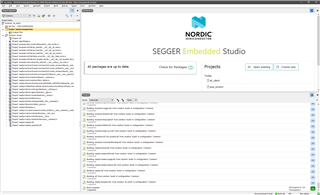

at_client build failed
I am trying to build the nRF Connect SDK project  "at_client" that is provided with the IDE. I also tried the asset_tracker project with a similiar result.
This is my first time using this environment. I want to evaluate the nRF9160 for a new product development.

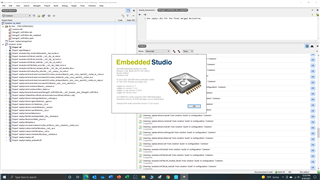

I am using nRf Connect v1.51
Rebuilding ‘modules/nrf/samples/spm_subimage-prefix/src/spm_subimage-stamp/spm_subimage-mkdir’ from solution ‘build’ in configuration ‘Common’
Combining ‘modules/nrf/samples/spm_subimage-prefix/src/spm_subimage-stamp/spm_subimage-mkdir’
Rebuilding ‘modules/nrf/samples/spm_subimage-prefix/src/spm_subimage-stamp/spm_subimage-download’ from solution ‘build’ in configuration ‘Common’
Combining ‘modules/nrf/samples/spm_subimage-prefix/src/spm_subimage-stamp/spm_subimage-download’
Rebuilding ‘modules/nrf/samples/spm_subimage-prefix/src/spm_subimage-stamp/spm_subimage-update’ from solution ‘build’ in configuration ‘Common’
Combining ‘modules/nrf/samples/spm_subimage-prefix/src/spm_subimage-stamp/spm_subimage-update’
Rebuilding ‘modules/nrf/samples/spm_subimage-prefix/src/spm_subimage-stamp/spm_subimage-patch’ from solution ‘build’ in configuration ‘Common’
Combining ‘modules/nrf/samples/spm_subimage-prefix/src/spm_subimage-stamp/spm_subimage-patch’
Rebuilding ‘modules/nrf/samples/spm_subimage-prefix/src/spm_subimage-stamp/spm_subimage-configure’ from solution ‘build’ in configuration ‘Common’
Combining ‘modules/nrf/samples/spm_subimage-prefix/src/spm_subimage-stamp/spm_subimage-configure’
Rebuilding ‘modules/nrf/samples/spm_subimage-prefix/src/spm_subimage-stamp/spm_subimage-build’ from solution ‘build’ in configuration ‘Common’
Combining ‘modules/nrf/samples/spm_subimage-prefix/src/spm_subimage-stamp/spm_subimage-build’
zephyr/zephyr_prebuilt.elf
\Nordic\v1.5.1\toolchain\opt\bin\arm-none-eabi-gcc.exe zephyr/CMakeFiles/zephyr_prebuilt.dir/misc/empty_file.c.obj -o zephyr\zephyr_prebuilt.elf -Wl,-T zephyr/linker.cmd -Wl,-Map=C:/Nordic/v1.5.1/nrf/samples/nrf9160/at_client/build_thingy91_nrf9160ns/spm/zephyr/zephyr_prebuilt.map -Wl,--whole-archive app/libapp.a zephyr/libzephyr.a zephyr/arch/common/libarch__common.a zephyr/arch/arch/arm/core/aarch32/libarch__arm__core__aarch32.a zephyr/arch/arch/arm/core/aarch32/cortex_m/libarch__arm__core__aarch32__cortex_m.a zephyr/arch/arch/arm/core/aarch32/cortex_m/mpu/libarch__arm__core__aarch32__cortex_m__mpu.a zephyr/arch/arch/arm/core/aarch32/cortex_m/cmse/libarch__arm__core__aarch32__cortex_m__cmse.a zephyr/arch/arch/arm/core/aarch32/cortex_m/tz/libarch__arm__core__aarch32__cortex_m__tz.a zephyr/lib/libc/minimal/liblib__libc__minimal.a zephyr/lib/posix/liblib__posix.a zephyr/soc/arm/common/cortex_m/libsoc__arm__common__cortex_m.a zephyr/boards/boards/arm/thingy91_nrf9160/lib..__nrf__boards__arm__thingy91_nrf9160.a zephyr/drivers/i2c/libdrivers__i2c.a zephyr/drivers/serial/libdrivers__serial.a modules/nrf/lib/fatal_error/lib..__nrf__lib__fatal_error.a modules/nrf/subsys/fw_info/lib..__nrf__subsys__fw_info.a modules/nrf/drivers/hw_cc310/lib..__nrf__drivers__hw_cc310.a modules/nrfxlib/nrf_security/src/mbedtls/libmbedtls_base_vanilla.a modules/hal_nordic/libmodules__hal_nordic.a -Wl,--no-whole-archive zephyr/kernel/libkernel.a zephyr/CMakeFiles/offsets.dir/./arch/arm/core/offsets/offsets.c.obj -L"c:/nordic/v1.5.1/toolchain/opt/bin/../lib/gcc/arm-none-eabi/9.2.1/thumb/v8-m.main+fp/hard" -LC:/Nordic/v1.5.1/nrf/samples/nrf9160/at_client/build_thingy91_nrf9160ns/spm/zephyr -lgcc -Wl,--print-memory-usage zephyr/arch/common/libisr_tables.a modules/nrfxlib/nrf_security/src/mbedtls/shared/libmbedcrypto_shared.a modules/nrfxlib/nrf_security/src/mbedtls/cc310/libmbedcrypto_cc3xx.a C:/Nordic/v1.5.1/nrfxlib/crypto/nrf_cc310_platform/lib/cortex-m33/hard-float/no-interrupts/libnrf_cc310_platform_0.9.7.a -mcpu=cortex-m33 -mthumb -mabi=aapcs -mfpu=fpv5-sp-d16 -Wl,--gc-sections -Wl,--build-id=none -Wl,--sort-common=descending -Wl,--sort-section=alignment -Wl,-u,_OffsetAbsSyms -Wl,-u,_ConfigAbsSyms -nostdlib -static -no-pie -Wl,-X -Wl,-N -Wl,--orphan-handling=warn -Wl,--out-implib=C:/Nordic/v1.5.1/nrf/samples/nrf9160/at_client/build_thingy91_nrf9160ns/spm/libspmsecureentries.a -Wl,--cmse-implib && cd ."
KB 48 KB 133.33%
B 64 KB 13.38%
B 2 KB 4.30c:/nordic/v1.5.1/toolchain/opt/bin/../lib/gcc/arm-none-eabi/9.2.1/../../../../arm-none-eabi/bin/ld.exe: zephyr\zephyr_prebuilt.elf section `.gnu.sgstubs' will not fit in region `FLASH'
SPM and app are sharing an SPU region. Cannot partition flash correctly into secure and non-secure. Adjust partitions sizes so they are placed in separate regions.
region `FLASH' overflowed by 16384 bytes
ld returned 1 exit status
build stopped: subcommand failed.
Build failed
