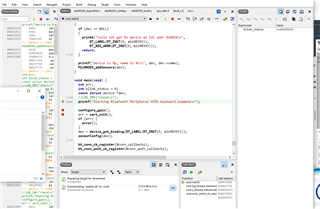

  I am developing application in nRF_connect_SDK v 1.4.2.
I have a problem in Debug the code
1. When i debug the code the breakpoints is not appearing

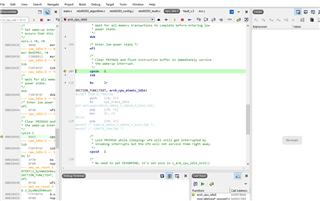

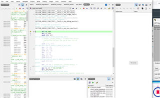

2. When i pause the code in middle of the debugging it moves to
and when resume the code it returns HARD FAULT and restart the code on next resume clicks
here its terminal logging

E: MPSL ASSERT: rem.c, 2148
E: ***** HARD FAULT *****
E:   Fault escalation (see below)
E: r0/a1:  0x00000003  r1/a2:  0x00000001  r2/a3:  0x00000001
E: r3/a4:  0x000190cd r12/ip:  0x00000000 r14/lr:  0x000264b3
E:  xpsr:  0x61000018
E: Faulting instruction address (r15/pc): 0x000264be
E: >>> ZEPHYR FATAL ERROR 0: CPU exception on CPU 0
E: Fault during interrupt handling
E: Current thread: 0x20002fb0 (unknown)
E: Resetting system

    You cannot break/continue while debugging a BLE connection, as halting will only halt the CPU and not the running peripherals.
    What happens is that a interrupt will be triggered when you resume the CPU, and the softdevice controller will find out-of-order events occurring; thus it asserts.
    This is similar when debugging the SoftDevice in nRF5 SDK.
    If you have issues reaching breakpoints, please set "CONFIG_DEBUG_OPTIMIZATIONS=y" and see if this helps.
