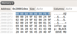

When I run the code and look at the location of NRF_I2S->TXD.PTR in memory, I see the 4 samples as expected (0x0000, 0x000A, 0x0000, 0xF6FF):

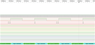

But when the data is actually being transmitted, the last sample (-10 or 0xF6FF in this case) is always replaced with 1 (see logic analyzer capture).
I see the same thing when I used different sized arrays for the audio data, as well as when I use a single channel instead of stereo. Some help would be much appreciated.

  • Thanks for the response, but I'm not sure the issue is related to the transaction length. I've done several tests with more samples, it's always the last 16-bit sample that's swapped with 1. The number of transactions has always been what I expect (the number of samples / 2).
    Even in this example, the first 3 samples are transmitted and the last sample is replaced with 1. I am seeing 2 transactions, the first transaction transmits 0 and 10 (as expected) and the second transaction transmits 0 (expected) and 1 (instead of -10), and then it repeats. You can see this in the waveform image. I see the same thing in every test I've done, the last sample is always replaced with 1.

  • Thanks for the response.
    What I'm doing here is transmitting this data on a loop, it's meant to be a tone that's repeated, not just a one-shot transfer. The I2S module does this automatically (i.e. after the last sample it cycles back to the first one). So it's meant to send a periodic signal as follows:
    0, 10, 0, -10, 0, 10, 0, -10, 0, 10, 0, -10, ...
    And what I'm actually seeing is:
    0, 10, 0, 1, 0, 10, 0, 1, 0, 10, 0, 1, ...
    The actual tone I'm sending has more than 4 samples, but I'm seeing the same thing, the last sample is always replaced with 1.
    I'm not clear on how zero padding would solve this issue. I wouldn't want extra zeros in the actual data, and having padding between periods of the waveform would mess with the timing given that this is sound data used to drive an audio DAC.
