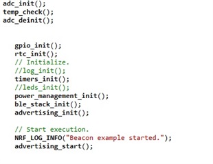

i am working with nrf52832. system on sleep mode is working ok in ble_app_uart example  by commenting " //err_code = sd_power_system_off();
//APP_ERROR_CHECK(err_code);" in sleep_mode_enter(). when i am working with beacon  example  system on sleep mode is  not working. it takes 1 ma current

  • 1. in ble_uart_example system goes to "system off sleep" ,mode after the completion of advertising duration.but what i did. i just commented "sd_power_system_off(deep sleep)" in sleep_mode_enter() declaration. now system working on "system on sleep" mode. rtc is working in sleep mode. and current is in uA.
    2. in beacon example . beacon advertisement is continues(never timerout). i have changed  duration to 500 to set 5 sec advertisement timer
    m_adv_params.properties.type = BLE_GAP_ADV_TYPE_NONCONNECTABLE_NONSCANNABLE_UNDIRECTED;
    m_adv_params.p_peer_addr = NULL; // Undirected advertisement.
    m_adv_params.filter_policy = BLE_GAP_ADV_FP_ANY;
    m_adv_params.interval = NON_CONNECTABLE_ADV_INTERVAL;
    m_adv_params.duration = 500;// 0; // Never time out.
    as i see idle_state_handle() is called in for(;;). so it should go to system on sleep mode after advertisement duration. is there any wrong step i did. current is approx 1mA
