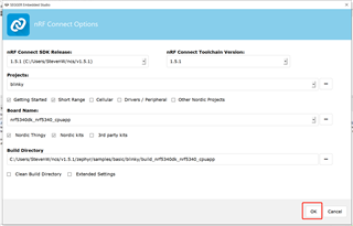

Hi, it's my 1st time using nRF Connect SDK for nRF5340. After click OK (see screenshot), I had this CMake error.
Because my previous folder contains white space (C:/Users/Steven Wang/...), so there was an error (cannot contain white space in segger directory). To solve this white space issue, I changed the directory to (C:/Users/StevenW/...). And this leads to the following error message.
Thanks in advance!
