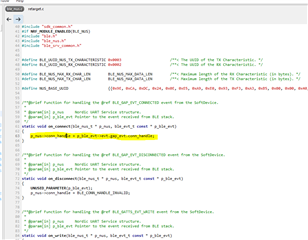

Hi everyone, so I have been trying to enable the nRF52840 to send notifications to the Nordic Connect app via a custom characteristic. The app can detect the custom service when it's being advertised and it connects successfully, but even after I enable Notifications, I cannot receive anything.
I used the ble_app_uart project and changed the main() function so that instead of being in an idle state, it repeatedly tries to send data in an infinite loop:

I tried to figure out what's going on by setting breakpoints, and it seems like it gets stuck in the execution of ble_nus_string_send() because p_nus->conn_handle = BLE_CONN_HANDLE_INVALID.
Any suggestions?
