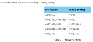

Step 4) Generating the BootLoader settings page hex file "settings.hex" by using this command in win10 command promot:
nrfutil settings generate --family NRF52 --application app.hex --application-version 1 --bootloader-version 1 --bl-settings-version 2 settings.hex
Win10 cmd returns:
Note: Generating a DFU settings page with backup page included.
This is only required for bootloaders from nRF5 SDK 15.1 and newer.
If you want to skip backup page generation, use --no-backup option.
Generated Bootloader DFU settings .hex file and stored it in: settings.hex

    StevenW807 said:
    I founded the issue! Because I'm using nRF52805, so when I generate the settings.hex, I need to use the correct hardware family version. Because I use nRF52805 (same Flash and Ram with nRF52810), so I need to use "--family NRF52810 ", not "--family NRF52".
    Good catch! Yes, the BL settings page must be on the last page of the flash, and then you must select a device with the same amount of flash memory as your device.

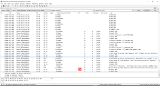

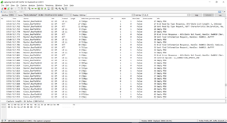

  • Hi Einar, here is the log for the issue of “it keeps showing "Starting DFU, Starting Bootloader" repeatedly. OTA DFU process is never finished.” It shows "Error 8 (0x8): GATT CONN TIMEOUT"
    nRF Connect, 2021-07-03
    Nordic_Buttonless (CF:0C:87:EC:12:1B)
    V 14:52:18.398 Connecting to CF:0C:87:EC:12:1B...
    D 14:52:18.398 gatt = device.connectGatt(autoConnect = false, TRANSPORT_LE, preferred PHY = LE 1M)
    D 14:52:18.842 [Callback] Connection state changed with status: 0 and new state: CONNECTED (2)
    I 14:52:18.843 Connected to CF:0C:87:EC:12:1B
    V 14:52:18.867 Discovering services...
    D 14:52:18.867 gatt.discoverServices()
    D 14:52:18.870 [Broadcast] Action received: android.bluetooth.device.action.ACL_CONNECTED
    I 14:52:19.175 Connection parameters updated (interval: 7.5ms, latency: 0, timeout: 5000ms)
    D 14:52:19.350 [Callback] Services discovered with status: 0
    I 14:52:19.350 Services discovered
    V 14:52:19.355 Generic Access (0x1800)
    - Device Name [R W] (0x2A00)
    - Appearance [R] (0x2A01)
    - Peripheral Preferred Connection Parameters [R] (0x2A04)
    - Central Address Resolution [R] (0x2AA6)
    Generic Attribute (0x1801)
    - Service Changed [I] (0x2A05)
       Client Characteristic Configuration (0x2902)
    Secure DFU Service (0xFE59)
    - Buttonless DFU [I W] (8ec90003-f315-4f60-9fb8-838830daea50)
    D 14:52:19.356 gatt.setCharacteristicNotification(00002a05-0000-1000-8000-00805f9b34fb, true)
    I 14:52:19.404 Connection parameters updated (interval: 48.75ms, latency: 0, timeout: 5000ms)
    I 14:52:24.016 Connection parameters updated (interval: 198.75ms, latency: 0, timeout: 4000ms)
    V 14:53:08.787 [DFU] DFU service started
    V 14:53:08.787 [DFU] Opening file...
    I 14:53:11.894 [DFU] Firmware file opened successfully
    V 14:53:11.895 [DFU] Connecting to DFU target...
    D 14:53:11.896 [DFU] gatt = device.connectGatt(autoConnect = false, TRANSPORT_LE, preferredPhy = LE_1M | LE_2M)
    I 14:53:11.905 [DFU] Connected to CF:0C:87:EC:12:1B
    V 14:53:11.906 [DFU] Discovering services...
    D 14:53:11.906 [DFU] gatt.discoverServices()
    I 14:53:11.921 [DFU] Services discovered
    D 14:53:11.940 [DFU] wait(1000)
    W 14:53:12.938 [DFU] Application with buttonless update found
    V 14:53:12.938 [DFU] Jumping to the DFU Bootloader...
    V 14:53:12.938 [DFU] Enabling indications for 8ec90003-f315-4f60-9fb8-838830daea50
    D 14:53:12.938 [DFU] gatt.setCharacteristicNotification(8ec90003-f315-4f60-9fb8-838830daea50, true)
    D 14:53:12.938 [DFU] gatt.writeDescriptor(00002902-0000-1000-8000-00805f9b34fb, value=0x02-00)
    I 14:53:13.218 [DFU] Data written to descr.8ec90003-f315-4f60-9fb8-838830daea50, value (0x): 02-00
    V 14:53:13.218 [DFU] Notifications enabled for 8ec90003-f315-4f60-9fb8-838830daea50
    A 14:53:13.219 [DFU] Indications enabled
    D 14:53:13.219 [DFU] wait(1000)
    V 14:53:14.241 [DFU] Writing to characteristic 8ec90003-f315-4f60-9fb8-838830daea50
    D 14:53:14.241 [DFU] gatt.writeCharacteristic(8ec90003-f315-4f60-9fb8-838830daea50)
    A 14:53:14.604 [DFU] Enter bootloader sent (Op Code = 1)
    I 14:53:14.608 [DFU] Notification received from 8ec90003-f315-4f60-9fb8-838830daea50, value (0x): 20-01-01
    A 14:53:14.609 [DFU] Response received (Op Code = 1, Status = 1)
    D 14:53:18.983 [Callback] Connection state changed with status: 8 and new state: DISCONNECTED (0)
    E 14:53:18.983 Error 8 (0x8): GATT CONN TIMEOUT
    I 14:53:18.983 Disconnected
    I 14:53:18.993 [DFU] Disconnected by the remote device
    D 14:53:18.993 [DFU] gatt.refresh() (hidden)
    D 14:53:18.993 [DFU] gatt.disconnect()
    D 14:53:19.022 [DFU] gatt.close()
    V 14:53:19.022 [DFU] Scanning for the DFU Bootloader...
    D 14:53:19.025 [Broadcast] Action received: android.bluetooth.device.action.ACL_DISCONNECTED
    D 14:53:19.038 [DFU] [Broadcast] Action received: android.bluetooth.device.action.ACL_DISCONNECTED
    I 14:53:19.163 [DFU] DFU Bootloader found with address CF:0C:87:EC:12:1B
    V 14:53:19.183 [DFU] DFU service started
    I 14:53:19.183 [DFU] Firmware file opened successfully
    D 14:53:19.183 [DFU] wait(1000)
    D 14:53:20.184 [DFU] wait(1000)
    V 14:53:21.189 [DFU] Connecting to DFU target...
    D 14:53:21.210 [DFU] gatt = device.connectGatt(autoConnect = false, TRANSPORT_LE, preferredPhy = LE_1M | LE_2M)
    I 14:53:21.727 [DFU] Connected to CF:0C:87:EC:12:1B
    V 14:53:21.729 [DFU] Discovering services...
    D 14:53:21.729 [DFU] gatt.discoverServices()
    D 14:53:21.732 [Broadcast] Action received: android.bluetooth.device.action.ACL_CONNECTED
    D 14:53:21.753 [DFU] [Broadcast] Action received: android.bluetooth.device.action.ACL_CONNECTED
    I 14:53:22.236 [DFU] Services discovered
    D 14:53:22.261 [DFU] wait(1000)
    W 14:53:23.243 [DFU] Application with buttonless update found
    V 14:53:23.243 [DFU] Jumping to the DFU Bootloader...
    V 14:53:23.243 [DFU] Enabling indications for 8ec90003-f315-4f60-9fb8-838830daea50
    D 14:53:23.243 [DFU] gatt.setCharacteristicNotification(8ec90003-f315-4f60-9fb8-838830daea50, true)
    D 14:53:23.245 [DFU] gatt.writeDescriptor(00002902-0000-1000-8000-00805f9b34fb, value=0x02-00)
    I 14:53:23.342 [DFU] Data written to descr.8ec90003-f315-4f60-9fb8-838830daea50, value (0x): 02-00
    V 14:53:23.342 [DFU] Notifications enabled for 8ec90003-f315-4f60-9fb8-838830daea50
    A 14:53:23.343 [DFU] Indications enabled
    D 14:53:23.343 [DFU] wait(1000)
    V 14:53:24.364 [DFU] Writing to characteristic 8ec90003-f315-4f60-9fb8-838830daea50
    D 14:53:24.364 [DFU] gatt.writeCharacteristic(8ec90003-f315-4f60-9fb8-838830daea50)
    A 14:53:24.415 [DFU] Enter bootloader sent (Op Code = 1)
    I 14:53:24.415 [DFU] Notification received from 8ec90003-f315-4f60-9fb8-838830daea50, value (0x): 20-01-01
    A 14:53:24.415 [DFU] Response received (Op Code = 1, Status = 1)
    I 14:53:29.507 [DFU] Disconnected by the remote device
    D 14:53:29.507 [DFU] gatt.refresh() (hidden)

    Here is the BLE sniffer log:
  • It seems like the Android device is constantly trying to put the nRF in DFU mode as if the bootloader never actually enters DFU mode upon reset. Some questions:
    • Do you see the same if you use nRF Connect for Desktop BLE to do the DFU? Or other DFU master?
    • I suspect you do not have enough flash space to use the debug bootloader, but perhaps you could use some GPIO's to debug in components\libraries\bootloader\nrf_bootloader.c to see if the bootloader enters DFU mode or starts the application? What does  dfu_enter_check() return?
    • Can you upload the sniffer trace files, not just the screenshot?
    • Do you use the bootloader with or without bond sharing (is NRF_DFU_BLE_REQUIRES_BONDS in the bootloader's sdk_config.h set to 1 or 0?) And do your application code reflect that?

    • Here is my sniffer trace file:
    OTA_DFU_Buttonless_nRF52832.pcapng
