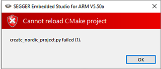

You should be getting some errors in the log in SES as well as the error window. Could you show me what kind of errors you're getting?
