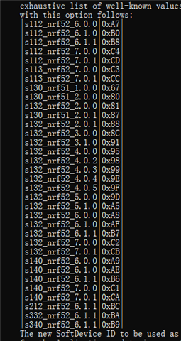

I use the latest nrfutil.exe to check, but there is no corresponding value. What values should I use?

Hi Luo,
You can find the Firmware ID for the softdevice in the softdevice release note. This file located inside nRF5_SDK_17.0.2_d674dde\components\softdevice\s132\doc
For S132 v7.2.0 it's 0x0101
As already stated in https://github.com/NordicSemiconductor/pc-nrfutil/issues/342 nrfutil should really be updated. See also https://devzone.nordicsemi.com/f/nordic-q-a/69907/bootloader-dfu-buttonless/286737
I ran into a similar issue with S112 + nRF5_SDK version 17.2 and SD version 7.2.
Wish the nrfutil would add these new values to the output of its '--help' command.
