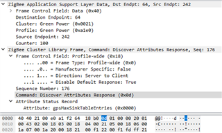

When I send a Discover Attribute to a Green Power cluster in a Green Power Endpoint, it seems that the dongle does not receive any response from the device. I know the device send a response because I can see the frame with WireShark but the Wrapper seems to ignore it and sens a Request Timeout.

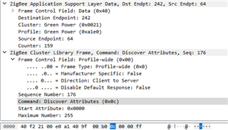

The command I use is the following :
zcl cmd -w -d {ieee_addr} 242 21 -p A1E0 C -l 0000ff
Thanks for your help.
    Do you have a sniffer trace you can share? Does the command packet you are sending look correct in the sniffer trace?
    The thing is that I can intercept any kind of data frame just fine but I can't intercept anything when I send any command with the Green Power Profile.
