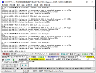

Please help me with this interrupt error
dk:PCA10095 0.11.0
sdk:ncs v1.5.0
example path:D:\ncs\v1.5.0\applications\2_hello_world_timer
example code:
test log:
Thank you for all your assistance.
Peter.Min

Please try to assign the intterupt handler with the IRQ_CONNECT() macro like how it's done for the GPIOTE irq in the nrfx use example.
Vidar
