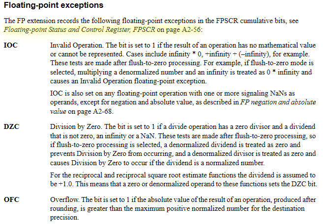

  • Hi Matthew, from the assertion in the code I can see that it checks for any of the following FP exceptions (because they most likely are the result of a problem in your code that should be fixed):
    • Invalid operation
    • Division by zero
    • Overflow
    I would recommend that you revisit all the portions of your code that uses floating-point arithmetic and check for stuff like 0 operands before performing a division, and then clearing the exception bit whenever it happens.
    If the result of such computations is used in the rest of the code, that might lead to other problems down the road (which is why I think this ASSERT was there in the first place.
    Here's a snippet from the Arm v7m architecture reference manual explaining in more detail:
    Good luck debugging!
