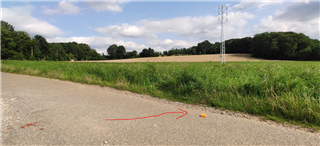

I was testing the GPS performance of the the thingie91. The default application (asset_tracker) works perfectly, but uses AGPS from the nordic cloud.
The asset_tracker_v2 does not use AGPS, and does not seem to lock in my case (even after 10+ minutes), even when positioning outside.
When enabling constant printing of status, I can see that it does see some satellites, yet does not get the lock. (I'd expect it to first get the eph. data and subseqently (like < 5 min) get the lock anyway)

Is this behavior to be expected? Is non-AGPS tested on the thingy91? I am aware that I could still try to use an active GPS antenna to boost the signal, but since with AGPS it gets a lock immediately I was hoping this wasn't required when just waiting long enough.
Thanks for your feedback.
Arnout
  • Thanks a lot for the detailed feedback, Arnout!
    The device should issue a fix whenever it has acquired at least 4 satellites and deems that the accuracy of the fix will be acceptable. So maybe the cellular activity prevents the device from reaching the above mentioned accuracy?
    However, on your picture I still can see that the sky is not really open and that there are objects which could interfere with the device. I wonder if you have the possibility to make a reference measurement in a park or similar, where you really have an open sky, and check if that makes any difference?
    By the way, what modem firmware are you using? If unsure, you can use the Request revision identification +CGMR AT command.
    Markus
