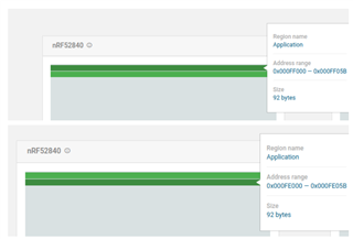

After checking the memory layout, this is what I can see:
So I continue:

So I used nrf Connect again to check if there is some memory overlap:
There is not, so I flashed it with the nrf Connect Desktop app and this is what I get:
Looks ok to me. Go next:

    As far as I can see you did not program the MBR (of a SoftDevice). The MBR is required for DFU, so even if you do not need a SoftDevice the MBR must be programmed. That can be found under <SDK>\components\softdevice\mbr\.
    (The MBR is a key component in DFU. It resides in the first place, so it always runs immediately. Then it checks if a bootloader is present (by reading the UICR unless a bootloader address is allready written to the page MBR itself), and if a bootloader address is specified, it starts the bootloader. If you have not programmed the MBR and page 0 is fully erased, no code i executed after reset as the flash there is all ff's.)
