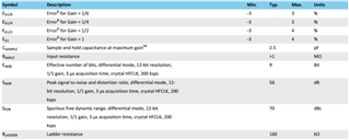

  • Thank you Karl,
    I have tested with pulldown enable and the pin reads ~0V now, so this works :)
    I have read the specification regarding the internal GPIO pull-down resistor, the typical resistance is 13kohm with a minimum of 11kohm and a maximum of 16kohm:
    With the above in mind, it looks like the Rladder resistance from saadc has less impact in this specific impact and easier to work with, since the Rladder resistance is typical at 160kohm:
    I think I will use the Rladder from saadc.
    Now just need to make sure the when the pulldown is enabled, the extra 160kohm in parallel needs to be taken into account
    Much appreciated, thanks!
    I am happy to hear that this achieves the functionality you were looking for! :)
    Yes, using the Rladder of the SAADC is of course easier in this case - I should have suggested it myself in the first place directly! :)
