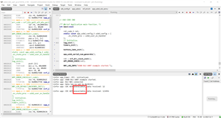

I don't understand how to use usbd_ble_uart example
Excuse me:
                     What is the reason for this log,What else do I need to do?
  • Hi Helen,
    The log comes from
            // Send data through CDC ACM
            ret_code_t ret = app_usbd_cdc_acm_write(&m_app_cdc_acm,
                                                    m_nus_data_array,
                                                    length);
            if(ret != NRF_SUCCESS)
                NRF_LOG_INFO("CDC ACM unavailable, data received: %s", m_nus_data_array);
    Do you open the serial port as the documentation indicates? In your computer's Device Manager, the development kit is visible as "nRF52 USB CDC Demo (COMx)". LED 3 turns on.
