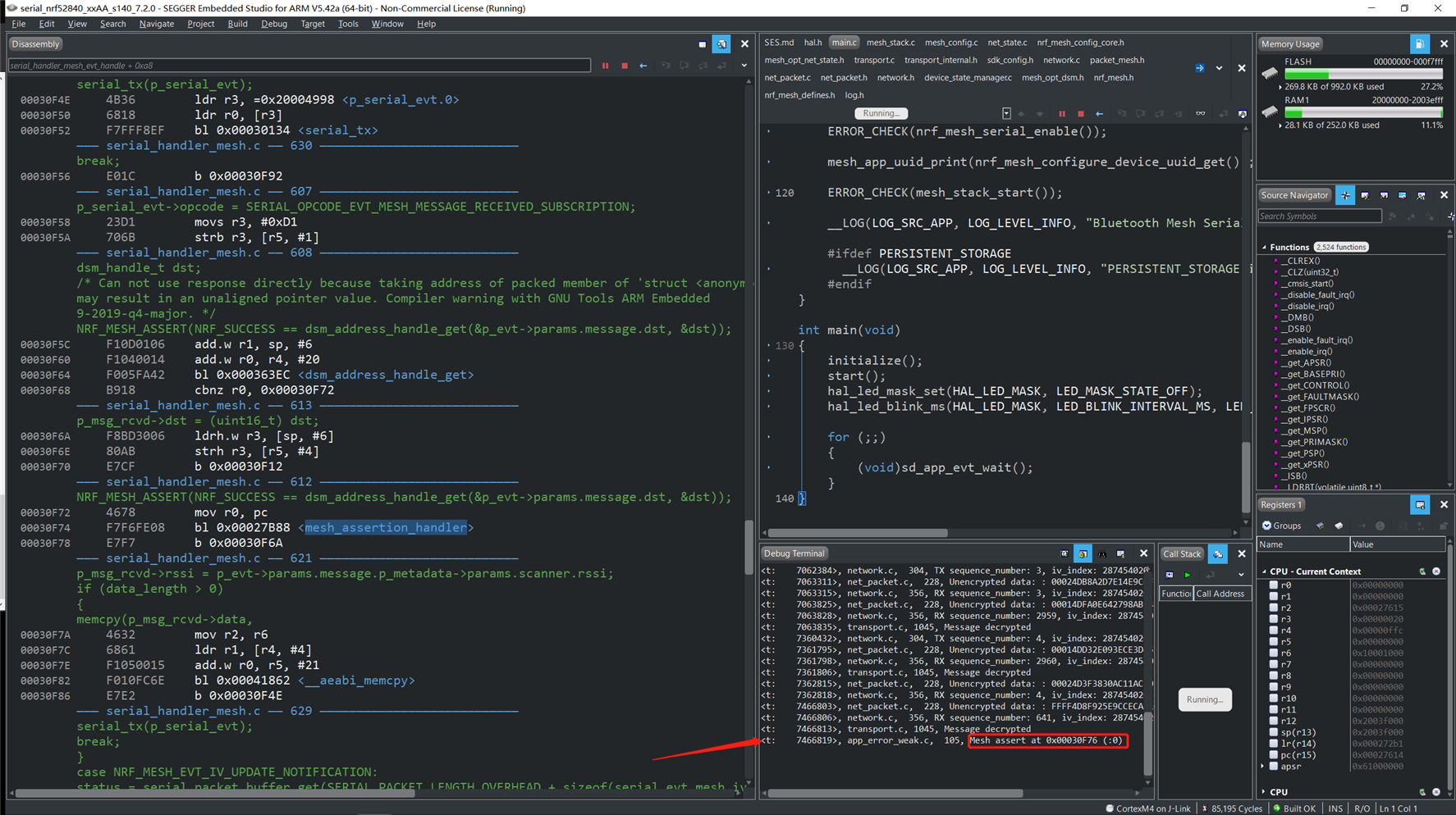

below is the 52840 log:

<t:    7466803>, net_packet.c,  228, Unencrypted data: : FFFF4D8F925E9CCECA61C9F29954
<t:    7466806>, network.c,  356, RX sequence_number: 641, iv_index: 287454020 dst: 65535 src: 45 ttl: 10
<t:    7466813>, transport.c, 1045, Message decrypted
<t:    7466819>, app_error_weak.c,  105, Mesh assert at 0x00030F76 (:0)
and the IDE shows:
I can't find the reason for this error. Could you give me a hand?
Thanks.
Oplinux
