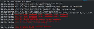

After letting the app run for some time, we inevitably land in an assert at this place:
WEST_TOPDIR/zephyr/subsys/bluetooth/controller/ll_sw/nordic/lll/lll_adv_aux.c:367
A screenshot of the error message:
I tried debugging the reason for the assert, but I'm not familiar enough with the BLE stack. It seems to assert that the radio is not ready at this point, for reasons that I don't know.
