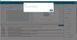

I have made a super hex file and getting the following issue. I have already made a super hex file successfully already but this time getting this error. Does any solution please?
Thanks!
Thanks!
I am using Anaconda Prompt(Anaconda) and using the following commands to make a merge file.
nrfutil settings generate --family NRF52840 --application 3.0.0.hex --application-version 0 --bootloader-version 0 --bl-settings-version 2 bl_setting.hex
mergehex --merge bl_setting.hex secure_bootloader_ble_s140_pca10056.hex s140_nrf52_7.0.1_softdevice.hex --output bl_set_s140.hex
mergehex --merge bl_set_s140.hex 3.0.0.hex --output bl_set_s140_app.hex
Which mergehex version do you use? I ask because some later versions have a bug that causes corrupt hex files. This is fixed in the latest release (10.12.2), so you should get the latest nRF Command Line Tools.
Thanks @Einar Thorsrud
Problem Solved
