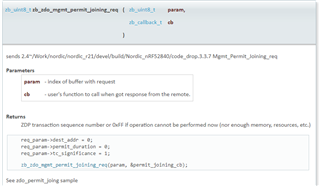

I would like to know how can I use the function zb_zdo_mgmt_permit_joining_req() to make the coordinator start the permit to join process forever. I understand that there is a parameter 'permit_duration' to specify the duration, which set to 0xFF, causes the joining process to occur forever. However, I would like to have an example of how to use this function.
I already referred to the documentation and this is what I see. However, in this, I do not know what value to specify for 'param'.

    I realize now that my previous reply was somewhat misleading, so I will try to clarify better. Previously, I was mostly thinking about opening the network by starting the network steering procedure with bdb_start_top_level_commissioning(ZB_BDB_NETWORK_STEERING), as this is the simplest way to open the network on a coordinator in our SDK, and what is usually done. However, you can also use zb_zdo_mgmt_permit_joining_req() directly.
    The function zb_zdo_mgmt_permit_joining_req() sends a mgmt_permit_joining_req command to a remote device, to request that device to allow or disallow association (depending on whether you open or close the network). When receiving this, the device issues the NLME-PERMIT-JOINING.request primitive, and they set the permit flag depending on what the permit duration is. The network is opened and closed as part of this primitive. The mgmt_permit_joining_req command must have a destination address, but you can set the destination address to be the address of the device sending the command, so that it also receives it, and then either opens or closes the network.
    When you instead use network steering on a device, the device broadcasts the mgmt_permit_joining_req command to other devices on the network. In addition to this, if the device is a coordinator or a router it also issues the NLME-PERMIT-JOINING.request primitive. So it will issue the same primitive, but the difference is that it also sends out the command to other devices, and that it does not need to send the command to itself, as the primitive is issued as part of the network steering.
    I believe the default permit duration that cannot be changed is for network steering, but I do not think it should affect zb_zdo_mgmt_permit_joining_req(). So this was a misunderstanding on my part. However, I have not tested mgmt_permit_joining_req using different permit durations myself. If you want to use zb_zdo_mgmt_permit_joining_req() you can do so using the following:
    zb_zdo_mgmt_permit_joining_req_param_t * p_req = NULL;
    p_req = ZB_BUF_GET_PARAM(buf, zb_zdo_mgmt_permit_joining_req_param_t);
    p_req->dest_addr = 0;
    p_req->permit_duration = 0xff;
    p_req->tc_significance = 1;
    zb_zdo_mgmt_permit_joining_req(buf, permit_joining_cb);
    ZB_DEFAULT_PERMIT_JOINING_DURATION is part of the internal stack, and changing this in zb_config_common.h will not affect the join duration.
