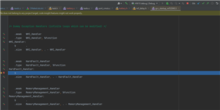

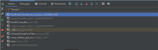

However, I found that the code stucks in PendSV handler, sometimes from Semaphore wait function sometimes earlier.(see pictures). Used same config as in blinky freertos example.
     This sounds like something happened at the time scheduler is triggered. Why not just move this functionality into another task? I normally do not want to do anything in the main thread after the scheduler is started. Not saying that using the main thread is a bad design, but saying that just keep it simple to tasks and ISR.
