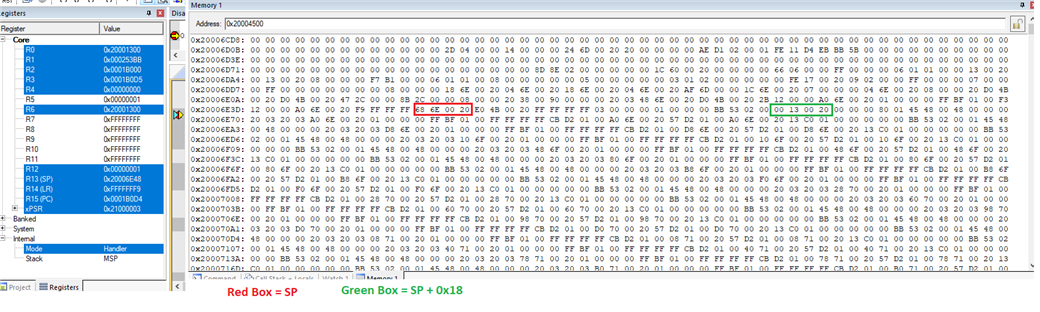

Hi All,
Setup:
SoC: nRF51822
SDK: 11.0.0
Softdevice: S130 2.0.1
I am facing occasional HardFault and It is happening randomly. I need to test device few hours to generate it and still no guarantee it will generate. It seems it is stack overflow issue.
My stack end address is 0x200075b8
I have captured below screen shot when HardFault handler called.
Can someone please point which instruction is causing issue?
Tarun
  • I found It :).
    Actually, my two function call each other indefinitely in certain situation which was making stack overflow.
    Previous LR was 0x000253BB (4 byte before green box). So. I derived problem should be at that instruction. I investigated around that instruction and found a condition when two function can call each other indefinitely.
