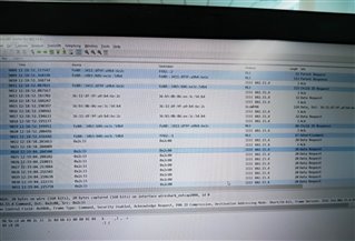

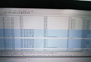

The sniffer: we saw a lot of Data Request packet from the child are sent out (because of re-transmission mechanic due to no ACK replay), yet no ACK received.
                   After sometimes, the child sent "parent request" MLE packets. yet the OTBR doesn't reply until some time later.

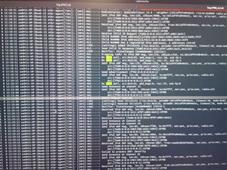

The OTBR: from the OTBR log, it actually didn't receive any "Rx data poll" from the RCP.
The Child: The child retransmit a lot of Data Request, after timeout, it try to re-establish the link with its parent (correct behavior).

  • Yes, the RCP(dongle) not only didn't reply ACK to Data Request, it either didn't notify related "rx data poll" event to its application layer - in this case it was OTBR OpenThread stack.  (So it seems the RCP actually didn't start rx)
    The consequence of these packet losses  were the child device declared the link loss to its parent, and sometimes OTBR declare this child's timeout state (depend on timeout setting value).  These application level problems were normal result of the above found problematic RCP behavior.
