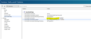

I was able to achieve this with SES Nordic Edition V5.50c (installed through the Toolchain Manager NCS v1.6.0):

BreBuild command in SES works fine.
But everytime I add an new file to my project I must generate a new SES Project and then I must add this option again.

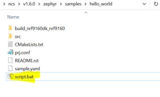

Is it a requirement for you to use SES? If you build using the command line, you can create a batch script where you can run a python script, west build (to build your project), and a python script again. Then you run the batch script directly to build your project and run the python scripts.
