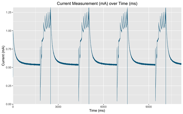

    Do you have any idea why using spis preventing nrf51 vcc to shutdown completely (stuck at 1.4V) when the power is off leading to a half Amp consumption?
  • Here is the current consumption of nrf51 when spis and BLE broadcast are used:

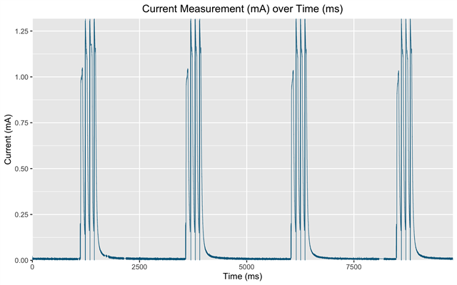

    Here is the current consumption when I don't use spis and only use BLE advertisement:
    You can see when SPIS is used nrf51 consumes around half mA even when the it is power off by the master (MSP430).
  • I solved this problem. I used SPI mode 0 (CPOL = 0, CPHA = 0) on nrf51 and (CPOL=0 CPHA=1) on msp430. Also, I have to wait at least 3ms after turning the nrf51's power on before sending any data through spi.
