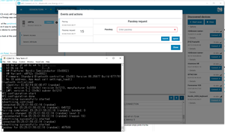

I am using NCS v1.6.0, nRF Connect for Desktop v3.7.0, and the Bluetooth Low Energy app v2.5.1 (part of nRF Connect for Desktop). I am using the nRF52840 Dongle with the Bluetooth Low Energy app and the nRF52840 DK to run the examples below.
I am looking at the peripheral_hids_mouse and peripheral_hids_keyboard examples in the SDK and for both of them, in the section of "Testing with nRF Connect for Desktop" there is a step where it says to optionally enable MITM protection. When I check this box, there does not seem to be any difference in behavior. I also do not see an option to either "use a button on the device to confirm or reject the passkey value."
Can someone look at this and let me know if I am doing something wrong here?

    Good point, I see the same here ;)
    I will have to check with the developers what the logic is behind this checkbox. Normally you want to use authentication by default, but then one might question why the box is there if it doesn't change anything.
    If I don't hear from them by tomorrow I will try to hook up my sniffer and see if I can spot any difference in the packet exchange.
