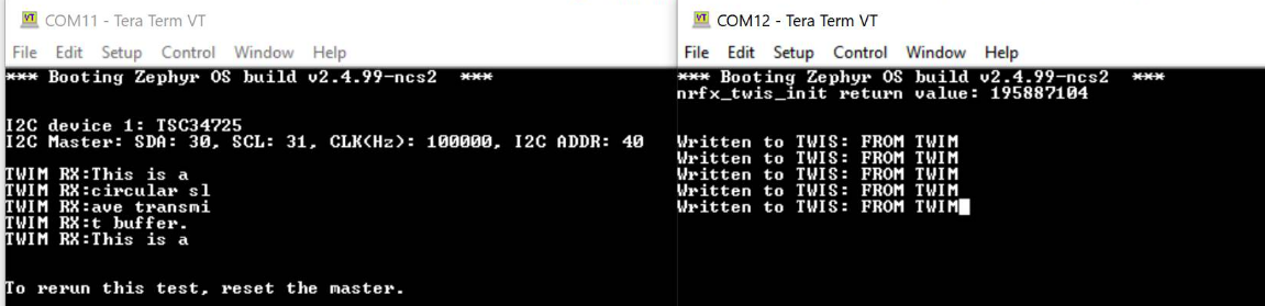

    A colleague (Jeff4BLE) created a project to demonstrate how to use an I2C Slave in NCS, check it out here:
    blinky-twim.zipblinky-twis.zip
    "This has been tested with ncs v1.5.1. Extract the attached to \zephyr\samples\basic\blinky-twis
    To test the attached, use two nrf52840dks. One as a Master and the other as a Slave.
    Connect master’s P0.31 (CLK) to the Slaves P0.27.
    Connect master’s P0.20 (SDA) to the slave’s P0.26.
    Be sure that the DK’s share a common ground.
    Connec the virtual com port on each DK.
    To run the tests, first reset the slave and then the master.
    TWIM can be built with two configurations. This is selected by changing the value of TWI_LOOPBACK in the main.c (Line 40).
    #define TWI_LOOKBACK false.
    The master repeatedly sends “From TWIM” to the slave.
    The slave cycles through a large message that is sent over multiple read requests from the master."
    "#define TWI_LOOPBACK true
    The master will first a message “Begin Loopback.” Subsequent messages will be the last message received from the slave."
