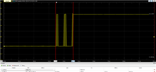

  • Thanks for the response. Nice trick with the pin toggle, especially useful as the oscilloscope will stop triggering after the failure and leave me with a capture of its dying breath - as pictured here:
    As the encoder handler is called twice per click-turn, and a character + release is only sent in the first of the two handler calls (when everything works properly), this image suggests that five reports were sent over ~20ms (character, release ... character, release ... character). Seeing as my connected device didn't continuously repeat the character, I'd actually revise to say that four reports were sent and the 5th caused Error 19.
    Now that I think about it, it's possible that the low-pass filter is so slow that the voltages may  not have settled by the 2nd call of the encoder handler, which I suppose could cause the handler to see inequality between enc_pins[0] and enc_pins[1] and thus send a 2nd character + release pair in a single turn event. So if I've got things straight, I've got at worst-case 8 reports sent over 20ms?
    I may try to lower the RC Time Constant anyway to avoid these issues, but the problem will still exist in the event that a user turns the knob very fast - is there a flag I can check to see the status of the send buffer? I removed the keypress queue functionality of the default HID Keyboard example, but perhaps I need to re-implement that if keypresses are going to come in this quickly. Ideally I suppose it'd be nice to expand the send buffer if possible too.

    One can do a lot of useful debugging with a scope ;)
    I think the best long term solution here is to decouple the hid updates from the encoder sampling, since as you say it is hard to predict how quickly the user will rotate the wheel.
    There is little point trying to send data quicker than the Bluetooth connection interval, since this is what dictates the rate at which new packets can be sent (unless you buffer multiple packets, but that makes more sense for applications where you are sending larger amounts of data).
    You can update some variable based on the encoder callback, and run some timer in the background that checks this variable and sends a new HID packet if the variable has changed since the last time. Here you can also check the status of other buttons that you might want to include in the packet.
    And finally there is the question of whether or not you have looked into using the QDEC peripheral for your encoder sampling?
    Assuming you only need one scroll wheel the QDEC peripheral is designed for just this purpose, and allows you to reduce the amount of software interrupts that you need to process when analyzing the speed of a scroll wheel or motor.

    Good idea to decouple the encoder and put it on a fixed-rate timer. I've done just that - in fact I utilized my existing timer that polled the normal keys and just had the encoder trigger that same process as well, incrementing a variable to keep track of how many characters need to be sent. I use a bool in tandem with this so that it can send a release on every other interval, otherwise quickly turning the knob would be interpreted as holding the key constantly. In case any other users come across this thread here and want a solution, here are the pertinent parts of mine:
