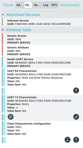

I am using this tutorial to write a custom service and I got to a point to add custom characteristics and got a few questions:
- I don't seem to find any characteristic with UUID 1401 under Unknown Service that was just added with a UUID 1400.
- I am modifying ble_app_uart to add a new service and a characteristic. Even though I have ble_nus_init() commented out from services_init(), I still see UART TX/RX characteristic. Why would that be?

  • Hi!
    For these two questions, I'd want to use a BLE sniffer to sniff the packets the device is advertising. That might tell us more about what's happening.

  • Hi!
    morpho said:
    For the BLE Sniffer, is the idea to run a python application while the BLE app is running that sets ups the service?
    The BLE sniffer is an application that runs on a separate Nordic device and sniffs all nearby BLE packets, and you can use Wireshark to see them on your computer.
    See nRF Sniffer for Bluetooth LE for more information
