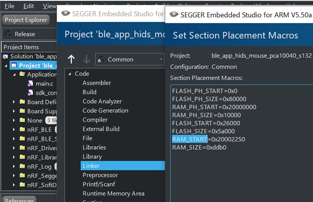

    Please try to change the RAM start location from 0x20002220 to 0x20002B88, as suggested by the warning.
    In SES, you can find the Section Placement Macros in the Linker tab of the Project Options. Please make sure to have selected the Common configuration, like shown in the included image:
    Do this, and let me know if it resolves your issue.
    Karl
