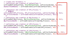

                    I'm porting other FreeRTOS projects to ble_app_hrs_freertos example In the directory nRF5_SDK_17.0.2_d674dde\examples\ble_peripheral\ble_app_hrs_freertos,I need to ask the following questions:
                    1、What is the maximum stack? Where can I set it?
                    2、How many stacks should be reserved for ble task?
                    3、The stack used by my other projects to be migrated is shown in the figure below,How do I set the size of the stack for my project?
     Probably you are asking if you have enough HEAP from which these tasks could be created? If so you should then look into the configTOTAL_HEAP_SIZE to see if you have allocated enough FreeRTOS heap which could be used for allocating stack for your other tasks.
