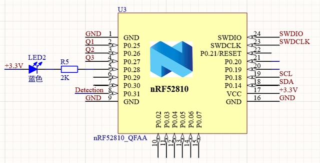

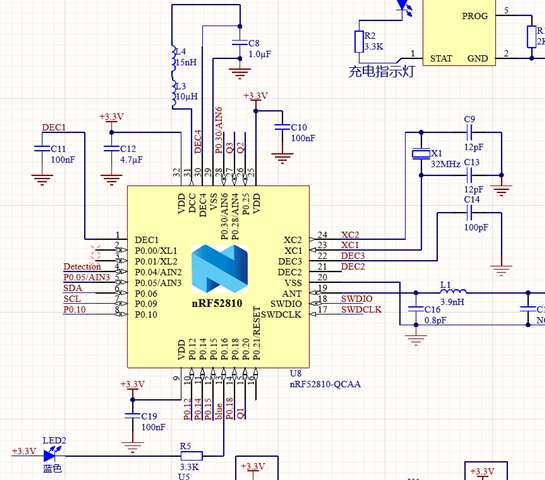

Hello, I meet some problem. The chip I used is nRF52810 QCAA, the softdevice I used is s112, I defined P0.09 as SCL and P0.06 as SDA, the TWI can't work and it stops in while(m_xfer_done==false){}.
However when I programed the same code into nRF52810 QFAA(only SCL changed into P0.18 and SDA changed into P0.14), the TWI work normally and can get data from mpu6050.
What's more, the button_0 event in nRF52810 QCAA doesn't work, although I have defined the touch, release and long push event. But when I changed the same I/O pin into button_1, button_2 or button_3 event, it works normally. All buttons are defined in same way. And when I programed the same code into nRF52810 QFAA, button_0 event can work normally.
All problem look like the code is suit for nRF52810 QFAA but not nRF52810 QCAA. What should I do, hoping for your help.
