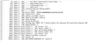

I get NRF_ERROR_FORBIDDEN error when I want to send a software message to the server device in the Light_switch application, except for the button. But when I press the button, the message is transmitted. What could be the solution to this?

Error Output :
  • Hi Erdi,
    I'm sorry for the late response. It's summer holiday in Norway and we have limited staff currently.
    Could you show us how you initialize mesh network ? Please pay attention to this documentation.
    So if you initialize mesh with NRF_MESH_IRQ_PRIORITY_LOWEST, you then need to call all Mesh API from the same context level, not from main() context.
    If you want to call the function from main() you may need to use a software interrupt and trigger the interrupt from main() so that it will be at NRF_MESH_IRQ_PRIORITY_LOWEST priority.
    If that doesn't help, please try to step into the code and let us know which exact function that returns NRF_ERROR_FORBIDDEN.
