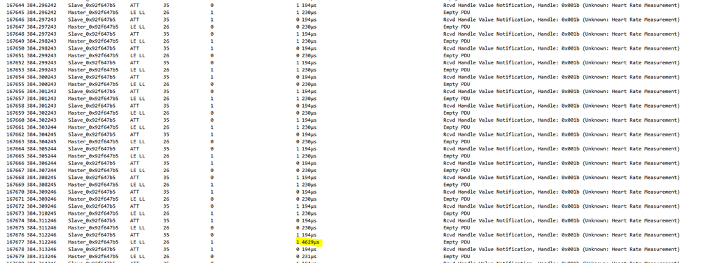

I'm trying to send 3 notify packets in a 15ms connection internal but I can send 2.
I'm using Nrf connect and Zephyr. is there a limit or a define to set this.

I will try to get you a sniifer trace but I do remember the more data flag being set to false on the second packet.
I also thought that Simon had tried this test with two nrf dk's. Could you do a sniifer trace of it working with an nrf dk central please. If it's a limitation of the central then I can explain this to my customer.
Thanks
There is a chance that it's hitting the limit of the stack. But we do need a sniffer trace to really understand the situation.
Please also look at the throughput example. As far as I know you can reach around 700kbps at 1Mbps.given that the ATT_MTU is configured correctly and Data length extension is applied.
I've created the same issue that i've been having with a basic hr example using NCS 1.6.1. in the 1st example I loop round 3 packets then sleep 5ms the other I sleep 30ms. See attached 2 sniffer traces. You can see in the 4ms trace it sends two packets per connection interval to one with 30ms sleep it sends 3 per con interval.hr_example_3packetLoop30ms_sleep.pcapnghr_example_3packetLoop5ms_sleep.pcapng

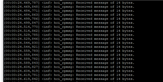

I've also looked at the log for the rpmsg and the messages seem to also be groups of two.3264.hr_mp_NC.zip

Normally issues with throughput on the nRF53 are caused by not configuring the hci_rpmsg application running on the network core properly.
If you take a look at the throughput example in the nrf repository you can see that they define a separate config file for this application, in a folder called child_image:
https://github.com/nrfconnect/sdk-nrf/tree/master/samples/bluetooth/throughput/child_image
Can you try something similar for your project and see if it improves the number of notifications you can achieve?

Thanks for the reply, I've checked the "nrf connect SDK project.." in hci_rpmsg_menuconfig and they seem to be correct, If there a good way to verify that the values have been built into the project?
if I add the child image folder do I need to regenerate the project in nrf Connect?

Hi Neil
Neil_CPD said:If there a good way to verify that the values have been built into the project?
If you open your build folder, and navigate to the subfolder \hci_rpmsg\zephyr, there should be a file called .config which contains all the pre-compiled configuration settings:
In this file you can search for the config parameter you are interested in (such as CONFIG_BT_CTLR_RX_BUFFERS), and verify that it is set as you expect.
Neil_CPD said:if I add the child image folder do I need to regenerate the project in nrf Connect?
Yes. This is not picked up by the build automatically, and you need to re-run cmake in order for these settings to be included.

Thank you for the advice. I can see all the config values that Hung has set in the project that he has attached but this hasn't made any difference I still only get 2 notify packets per connection.
Do you have a nrf5340-dk that you could test with and attach the build folder so I could program the hex as a test please?
