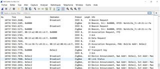

We are using the nRF52840 dongle (PCA10059) with the CLI agent software  as a Zigbee network coordinator, and the Digi's XBEE S2C as a Router.

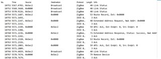

We are using XCTU to configure the S2C. But we are having the same issue. The router will be commissioned and then leave the network shortly after.
We also flashed another dongle with the nRF sniffer, but we are not able to locate where the error might come from. We spent the few last days on this issue whithout any promising results.
