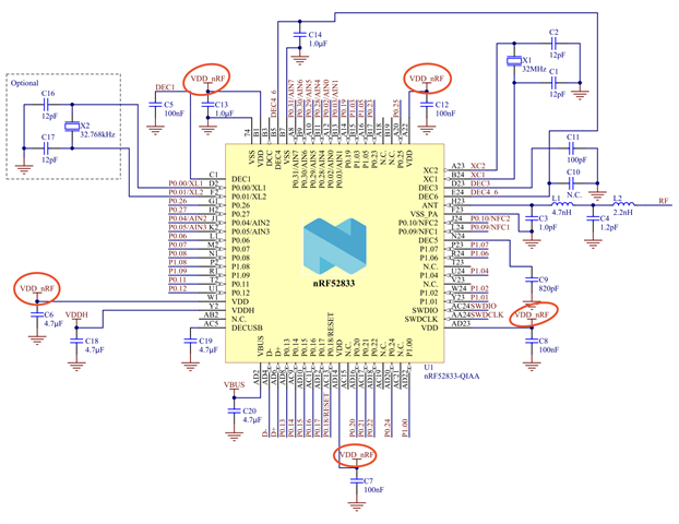

NRF52820 VDDH Schematic w/ No Usb?
I'm starting to design a custom board around the NRF52820 using a 3.7v battery and there is no reference circuity for VDDH using Battery/Ext. regulator. Any tips on what I need to do to port over another reference to use with VDDH?
Can I just take a non-VDDH circuit and not connect VDD, then it will be high voltage?
Thanks, it's my first design and I'm a little confused. The other boards have reference circuits for VDDH and a battery, but not the 52820 unfortunately. There is however 1 reference circuit for USB & VDDH. Could I just use this one?

  • Hi.
    akidality said:
    When the schematic shows VDD_nRF ~ this is meaning connect to other VDD pins on the NRF?
     Yes this is correct.
    I would recommend that you submit the finished design for a review. This is done by opening a private ticket and uploading your schematic and Gerber files. This service is of no cost to you, and may save you time in the case you overlooked some aspect in the design process.
