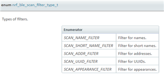

    2. On line 3 I am getting a 'use of undeclared identifier SCANN_ADDR_FILTER' error. I checked the documentation, and I do not know how to define SCAN_ADDR_FILTER properly.This is all I can find:
    These two issues are likely happening for the same reason. Have you remembered to include the scanner header nrf_ble_scan.h file in your project?
